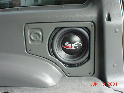

I am using the Q Logic box with a Rockford Fosgate HE2 10" I love it! The sound is great and not loosing any space is awesome.
More images at my home page in my sig.
My RF 10 has a Top Mount Depth of 5 11/16 inches. I don't know what the depth of the Infinity is but mine fits and it is a huge magnet.
