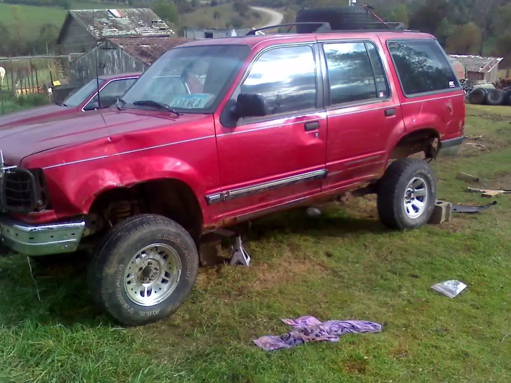

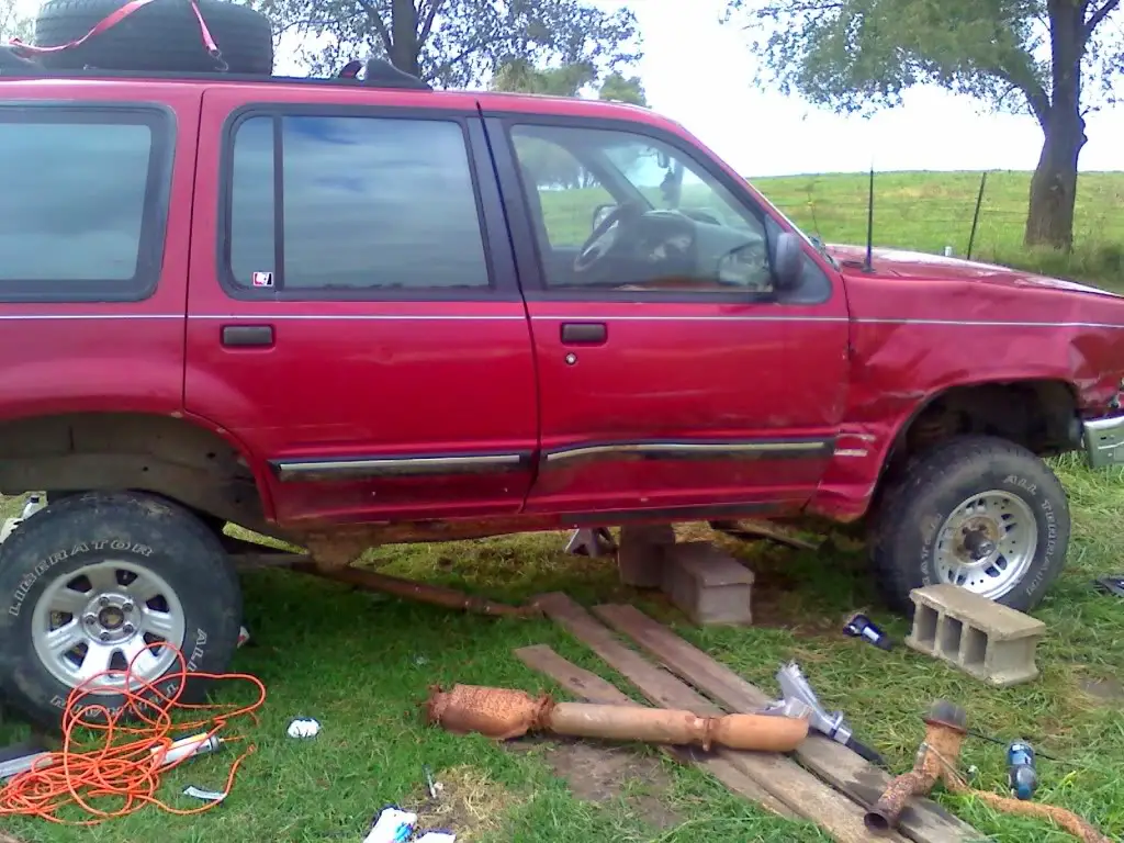

i ran across this for sale on craigslist...for 250 dollars..it is a salvaged title and as the guy claims...it was fixed and ran fine then one day stalled and never started again. its a 1991 xlt.... He believes its the electronic ignition module (in his terms exact) do you think it'd be a good buy with only 112k miles on it?
like i said i want it for a parts truck as my explorer well looks like this with a bad transmission and its at 275k lol.
mine is a 1994 xlt...and one other question is there any differences between the 1991 and the 1994 (unsure of any mid generation changes) that would make some things not interchangeable?
and sorry i forgot to downsize the 2 pictures...and dont mind teh snow around the one hahaha damn iowa winters and im sick of the snow!
if all you need is parts then id say its a great deal, just take the Vin to ford and figure out what T case and tranny it has. (or just look at it) i bought a explorer for 300 (same as mine) for parts and it has already earned its value.

well the tables have turned slightly...my tow guy bailed on me last minute...so the guy is going to deliver but is asking 350 with the delivery! im still going for it =) considering its a 90 minute trip one way and he's going to have to clear the snow (which originally i agreed to do)
The only MAJOR running change in the explorer was a change from batch fire injection (91-93) to sequential fire (94). So engine computer and related parts will be different. Sure wish I could find a deal like that for mine....

well got the truck... the hood was bashed up a bit (other front end parts were good) its a bit obvious it's been parked a little longer than a few month due to the wasps nest and rat nests made under teh seats...but i still went for it now he claimed it was the electronic ignition control (as he called it) what is he actually referring to and what about a picture if someone has one? and can i pull the one off my 94 and use it to try adn get this fired up so im able to easier move it to where its final resting place will be (which atm is currently a 8 foot plus snow drift behind a shed lol) thanks again guys...and btw im liking your ex! maybe someday mine will be fixed up enough to look clean andmean versus like a hunk of junk work in progress as my family says lol
The ignition module in question is mounted on the rad cradle behind the battery. Remove the battery and you'll see it, it's in plain sight without the battery.
