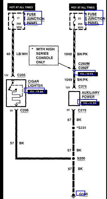

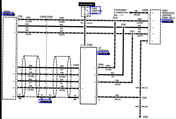

Anyone have access to the High Series console wiring diagram? This is for the non-message center version. So need the pinouts for the radio and HVAC controls and cig lighter. Can't seem to find a diagram anywhere!

Maybe these ones?

Sorry I couldn't get the pics scanned earlier - I've been sidetracked the past two days repairing my girlfriend's iPhone (took an unplanned trip through the washer...) Anyway, the pinout that I have for the 2000 Ex is different from what MarT posted, so I'll post mine also. I guess Ford has gone through a few revisions of the connector...
(includes wire assignments for CD Player, Message Center, Rear Controls, and Aux Power - cell phone wasn't an option in 2000)

Awesome! This helps alot!
Now I need to figure out what the audio corporate protocol A and B are ????
ASYS?
And how to wire this into an afterharket head unit
But I feel as I'm getting much closer! Thanks!!!
-Mattie
ASYS On and Audio Corporate Protocol A/B are for communication between the CD player, radio, and rear controls. All the information I could find on them (back when I was installing my sound system) indicated that they are proprietary to Ford.
To the best I can tell, there is no way to wire the rear controls or factory CD player directly to an aftermarket HU. However, I believe that there is an adapter that allows some of the rear controls to work with an aftermarket HU.
