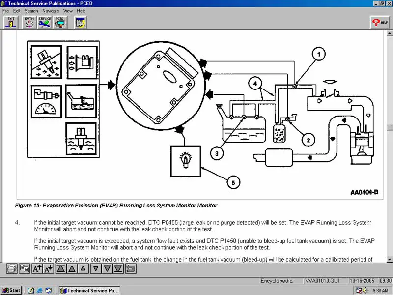

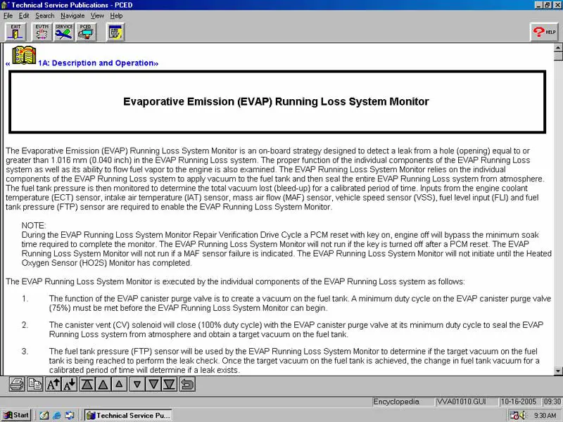

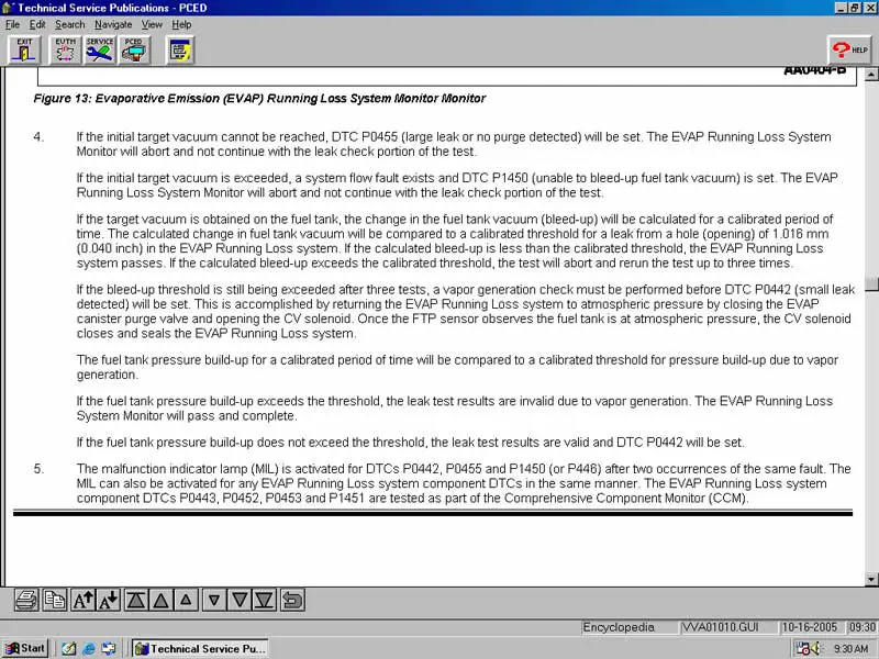

96 is OBD 2 which means that it performs self tests of the fuel system to determine if it is leaking. If you had a leak, you should get a Check Engine light because it would fail the pressure test.

OBD 2 Leak test

Well from those diagrams and reading everything a leak somewhere in the fuel system is ruled out seeing as I dont have a CEL light. Thanks dogfriend. Now I have to find out what the problem is.
