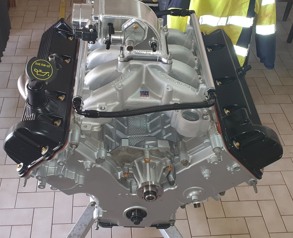

Hi all, I'm wanting to run holley terminator for engine management and my question is, if all sensors from stock ecu are unplugged will stock ecu still run everything else it normally does. Don't need to worry about trans as I have full manualised 4l80, 1000hp turbo built 02 explorer.

4.6 2v and yes 7" digital dash but was hoping everything else that isn't related to engine management and transmission control will still operate, pats, aircon, abs and all other dash controls and safety features.
Are you able to run some simple inputs to the pcm at least. Can you tee into the signals for at least the crank position, CHT, and TP? I think if the pcm at least saw rpm and load and engine temp, you could retain A/C, and the pressure sensors of course. Do you EATC or manual climate control? 02 explorers use simple SCP, UBP, ISO networks, so you might be ok with the other stuff.
Also, how about some pics? I would like to see what you have. It sounds pretty nice.

Ok I thought if the pcm saw the engine running via crank sensor it would start throwing codes with every other sensors unplugged, still in the process of putting it all together still sitting on axle stands but hopefully have it up and running in the next couple months and will post pics.
