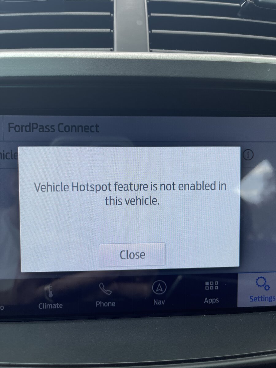

Hey all,
Hoping someone here may have the solution to the problem I am having.
I purchased and installed a Navi APIM from an early build 20’ Explorer into my 2017 XLT with Navi. Once installed I loaded my Asbuilt data from my old module into the new one. At the same time I finished my retrofit of a hot spot enabled TCU. I am using Ford PIFA’s for both connected car and hotspot they are connected using OEM cables. My issue is not being able to enable hot spot in settings. The FordPass tile is showing up, I can tap the hot spot menu under the FP tile but when I do I get a pop up that says “Vehicle Hotspot feature is not enabled in this vehicle” I’ve reviewed the APIM asbuilt data consulted with another DIY’er from the F-150 forums, we have made changes in hex for blocks 7D0-02-02 and 7D0-02-03 and we can’t seem to get the hotspot functionally to work.
Any suggestions? I’m sure I forgot to include some info y’ all may need, be happy to provide just let me know.
