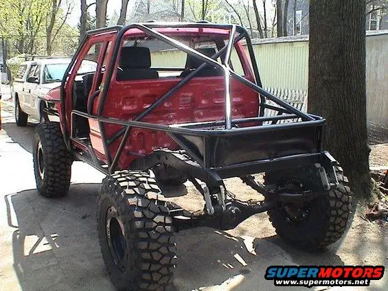

im going to do this with the rear eventually::
looks *****in' :D
