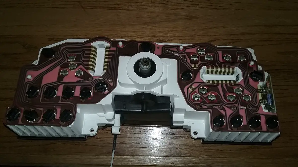

Someone knows how many bulbs has an instrument panel ? all are 194's?
i cannot find this info....
Thanks for your help!
17, all 194.

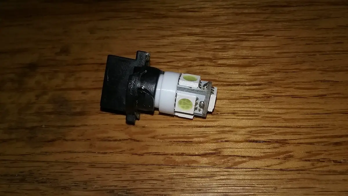

swapped to LEDs years ago. which makes the color more vibrant. but Made the mistake of getting super cheap ones though. They can glitch out and flash due to poor solder quality (guessing).Kept incandescent in the CEL & oil warning lights just in case the led's weren't as reliable.
