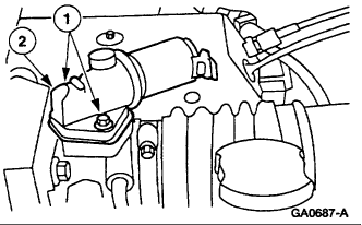

The noise sounds like it might be your IAC going bad.

The pic shows the IAC
YU3Z9F715AA
. $67.82
