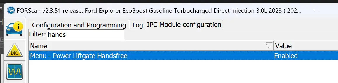

IPC:
Easy Config, search for hands, and you'll see handsfree pop up. Change to enable. This optional, since it worked with it disabled. I wanted to keep it consistent.
Finally, you might have to run the "BdyCM Local Interconnect Network New Module Calibration" under the wrench in forscan. I did not. It won't hurt to do it anyway. Since it's a new module on the LIN Bus, the Body Control Module needs to learn that it exists.
