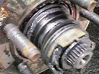

thanks for the adivce, but even after lookin at it, i dont see how i get the rotor off. the little cam thing or whatever they call it. how the hell does that come off?
The splined washer, cam, and thrust washers just pull off. They are held in place by a "C" clip around the axle shaft. Do you have the 2 3/8" axle nut socket to remove the wheel bearing adjusting nut (it can be hard to find). You will also need a torque wrench for re-seating this nut to correctly seat the wheel bearings otherwise you will ruin them if not correctly torqued down. To reinstall the plastic cam you will need to make a plastic cam installation tool out of a 1 1/2" pvc plastic pipe you cannot install the cam without this.

From right to left : Splined washer, Cam, Thrust washers. Note the "C" clip has been removed prior to this picture.
After pulling the above off you can extrat the locking key from the Wheel bearing adjusting nut.
i still dont see what the c clip is. especially since its gone in the first pic. not sure what to look for. ahh ****. i dont know man. i really dont wanna mess it up.
