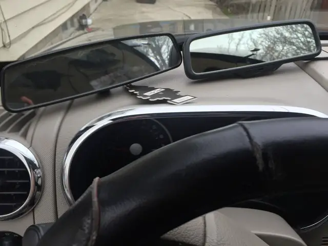

This is on a 4th gen, but should be the same on a third or even second, with the exception of finding another power source for the mirror. The 3rd gen mirror will fit the same, but is more curved, where the 4th gen mirror is more boxy. Same 3 pin wire harness but different colors. Still only need a ground and switched 12v.

The two different OEM mirrors:

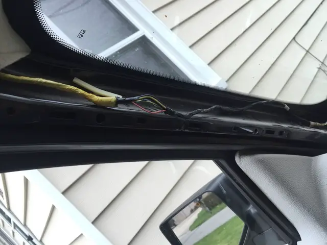

3. Pop your A-Pillar cover off. This is the easiest spot to tap into the existing wiring. We're going to use the power and ground from the compass module.
I cut some of the rubber tape covering the wiring. You can do it higher or lower, doesn't matter.

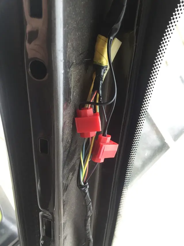

4. You're going to tap into the BLACK wire for the ground, and the GRAY w/ORANGE STRIPE wire for the switched 12v. (I would highly recommend double checking with a test light or DMM to verify. Mine is a 2006, but sometimes they change wire colors through the years)
I used some quick splices. These aren't my favorite, but they're on the inside, and wont be exposed to water or weather, so they'll be just fine.

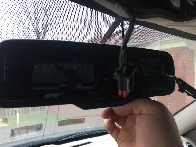

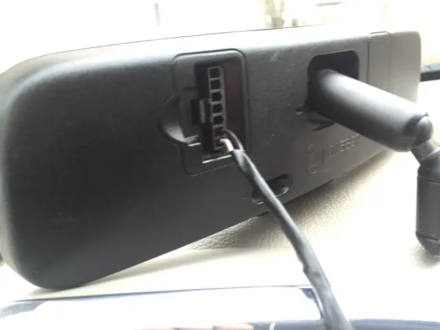

5. Now I had already done this part inside where its nice and warm, but you'll need to connect the corresponding wires to the mirror harness. Like I mentioned above, there will be THREE wires in that connector, you only need two. I used a little pick and pushed the un-needed connector out to keep it clean looking. I wrapped it with electrical tape, as thats how it was from the factory anyways.
For my 2006 it was as follows: BLACK= Ground, GRAY w/ORANGE STRIPE= 12v

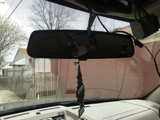

6. Once you have the wires connected, TEST IT! I slid mine onto the mount loosely, turned the key on, and because it was daylight outside, it wont dim, you'll have to put your finger over the sensor on the back near the wire harness. If you turn the mirror around, you cant miss it. The mirror should get pretty dark depending on brightness outside.
Key on, but not dim:
Key on, finger covering the daylight sensor in back, success!
Now, clean everything up, hide the wires, zip tie excess, put your A-Pillar back on, etc. Plug your compass module back in, snap it back on, I opted to put my wiring inside of the little black plastic loom that comes down from the headliner with the compass wiring. It fit perfectly. Looks OEM as can be. Best $30 mod ever!
