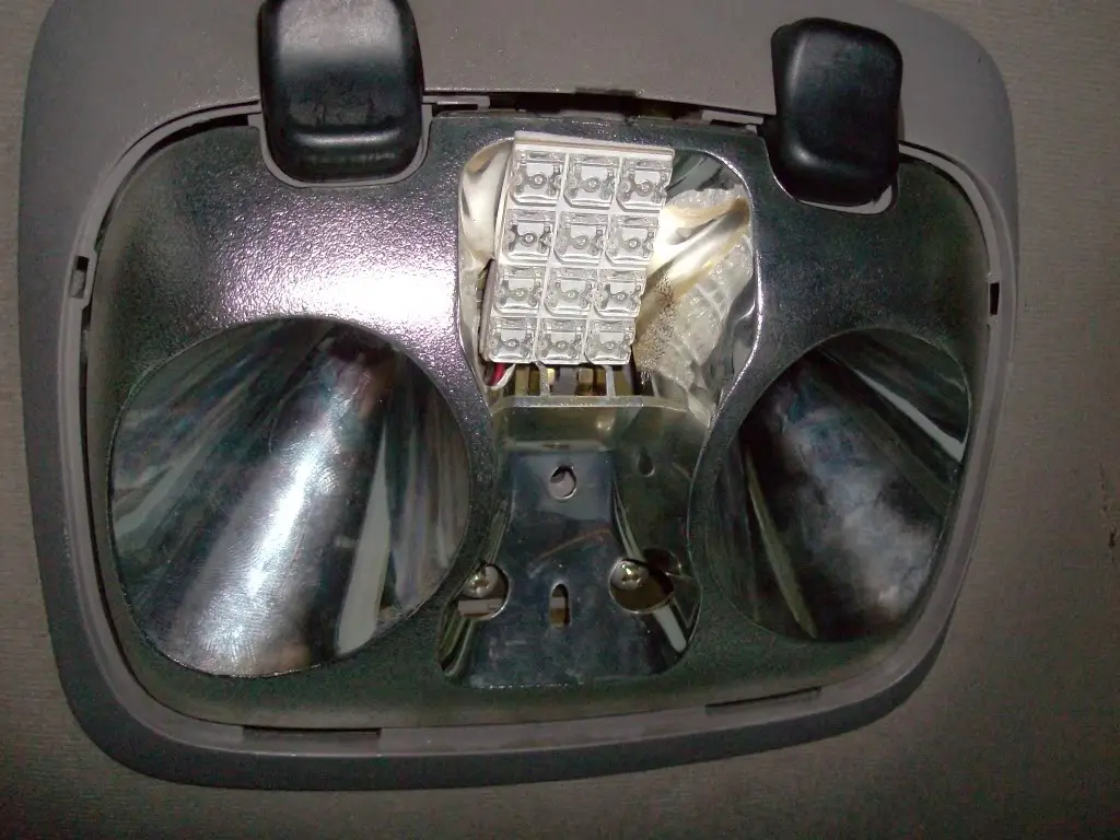

i just converted my main interior lights to leds anyways. draws less power and they are brighter. got both my front dome light and my rear cargo light to blue leds
