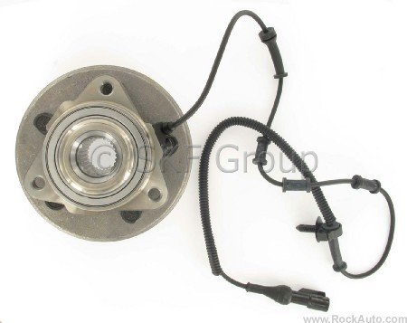

Thanks, I found a pair of hubs on 1A Auto for $100. I told my FIL that it's worth a shot trying to replace those out first. I've never some across a bad wheel bearing and while I'll turn a wrench once and a while, i'm in no way a mechanic so I didn't want to tell him that was definitely the issue. But, it did seem to make the most sense to me.
For the steering I'm going to test the pump tonight by bringing the truck up to 2000 RPMs while parked and turn the wheel to see if there is any difference. If nothing changes then I'm going to try to spray some WD40 in the U joints on the steering column to see if that helps.
I'd only get SKF BR930456 HUBS.

Hmm, good to know. Guess I'll order up some front ones then. It's got 174k on it so they are probably all due for replacing anyway. Thanks!
Sorry for the late reply, I just wanted to follow up on this thread to let anyone that might read this know everything went. Spraying penetrating oil on the steering column took care of the binding issue when turning the wheel and replacing the hubs eliminated the grinding noise while driving.
