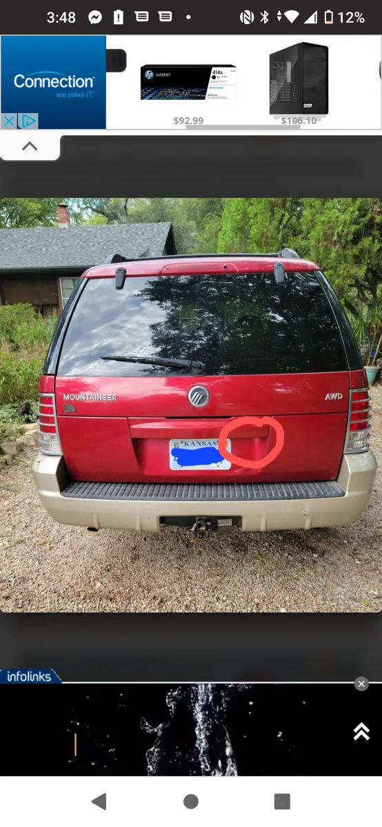

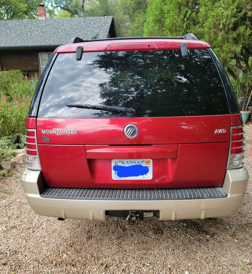

I am sure this will turn out to be a dumb question, but how do you open the rear window ?

Little rubber button located to the right of the main hatch handle. If you look up under there you will see it near top right corner of license plate. It activates an electronic actuator that pulls a cable to open it. The cable assembly is notorious for breaking (small plastic clip on the cable) but you can order a new one online if that's the case. It's not a stupid question. I bought 2 of my 3rd gens from 2 different girls who had them for years and never even knew the glass part opened. I hit the little button to open it and their eyes got wide and jaws dropped.
