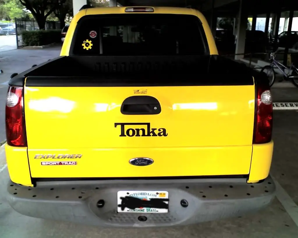

Dora the Explora, thats funny. Mine is my Tonka Truck.
nice tonka! i had one just like it when i was 7! thanks for the link and the info fellas, now im torn between an aussie and the powertrax. everyone on this forum seems to run aussies and i havent seen too many people complain about them. im going to have to do more research while im pretending to be at work!
