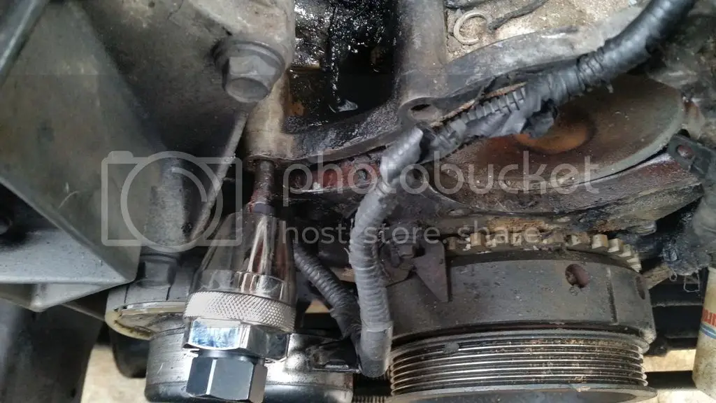

This is close to one of the worst experiences i have had in working on cars in all my time doing it.
the fan clutch was easy, $22 i got a 36mm 2 1/2 ft crescent wrench (and a 35mm to be sure) from a tool parts online store.... so the fan clutch came of like a dream, so far so good (my car is also flo-grown never saw snow in its life)
however the water pump.... yay...
so i find that before starting someone has already sheared off one bolt on the right hand side by the bypass hose....and just used what seems like 3 tubes of RTV to fix it ( to their credit it actually was holding perfectly fine - i think they over torqued the other bolts to compensate) but the same bolt head snapped off for me as in this post...
now i am not about to strip half the front of the engine, sorry this is my only car, my daily driver and i live in butt-funk central FL luckily i have about 1 inch of bolt left on both sticking out from the timing chain cover.
i have my trusty stud puller which served me well on the the thermostat ( same problem sheared bolt head)
so now i am sitting here in my garage on a wet florida day, drinking beer, listening to 80's music, after heating the living smoke out of, and pb blasting the living snot out of the two remaining bolt studs.... i am hoping the shade-tree gods will smile on me i will sacrifice many a beer to them today, and tomorrow the studs will break free ( like free willy)
however if not, is my only option to pull the timing cover? that sounds like a pain in the bootyhole or should i do like the previous person, and just over tighten ( i am replacing all the bolts because one was very close to snapping while removing - one of the presumably over torqued ones next to the busted one) and use a tube and a half of RTV and maybe even some JB weld.... the car has 226k on it, and i am thinking it may not have much of a good life left, hell it cost $900 3 years ago bought in an emergency, and made 2 trips to chicago and back from Florida at short notice)
i want to do the proper thing and drill out the studs re -tap and reassemble. but that is about a weeks work, and i really need to save my time off for family visit from the motherland this summer.
options? apart from more beer ( today is a write-off the rain is just really annoying, and of course all week while i was in the office it was 85 degrees and sunny, go figure!)

Well the shade-tree gods smiled upon me... at least once this morning ...sadly I am only batting .500 since the other bolt decided it wanted to snap off flush with the cover... oh well...
Still it's the small victories.... I am not going to bother with stripping down for one bolt and am going to use sealant and other things for now... since I need a head gasket soon anyway, the temp fix will last until I have th top of the engine off.
Still it felt good to extract one of the busted studs...
Sadly I could not find replacements and I am stuck at home until tomorrow when I can get a ride to the store to fix..
Maybe I should have sacrificed more alcohol to the shade-tree gods yesterday!
