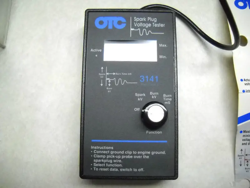

A spark gap tester tool will compare the amount of spark energy on each cable:
I have a spark plug cable voltage tester from OTC:
This has a digital readout of the actual voltage on each cable. The spark gap tester is second best from an economical point of view.
