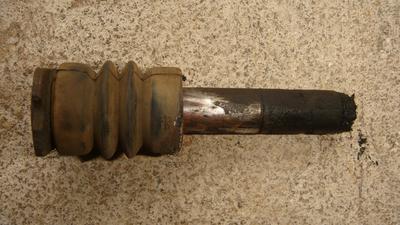

This is what happened when a "friend" did a brake job after one year using regular chassis grease not designed for high heat. Gummy and binding caliper pins. Also avoid getting brake cleaner on rubber. Swollen boots in pics below. Lesson learned.
Holy cow. This is definitely what the pins looked like when I did a rear brake job on my wifes 99 Ford Taurus. I'm not 100% sure if it was a botched previous brake job repair or if it was just an accumulation of 16+ years of no service. On all the brake jobs I've done, I've used the same tube of AGS brake grease (not sure if there's a shelf life on this stuff...I've had it for a lot of years, but It's almost empty anyways) -

That's AGS Sil-Glyde, even says on the tube. Excellent stuff, don't ever recall reading a complaint about it. Biggest concern with anti seize is it's usually petroleum based and bad for rubber. Here's a good article and site for general auto repair info.
