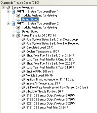

I pulled the codes using my code scanner and found some interesting stuff.
Codes P0171 and P0174 which are bank one and bank 2 system to lean
Code was cleared but has not come back. Trying t figure out what caused look what else I found

The other thing I found was my heads up display said the outside tem was 62F and my computer was reading 73F as seen in the screen shot below. I had just started the truck after it sitting over night so the extra 11 deg was not from the engine. Could this being causing a problem? Is their an intake air temp sensor? Or is it just the MAF? Should I clean the MAF? my gauges are below.

Sines the code has not come back yet i have not been worried about it. the only thing that did bother me was the air intake temp. it was 11 degs more then my heads up display. I had just started the engine so it should have been the same temp. Does anyone else think this is a problem? also i found it strange that the calculated load at idle was 30%. not sure what any of the other numbers mean.
