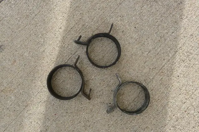

And still have these blasted things that came stock on our trucks....
Do yourself a favor and just replace them while your at it. I just had to remove all of mine when I replaced my radiator, and 2 or the three leaked no mater what I did once I put it all back together. Ended up having to drain the system and remove the belt to get the one off the lower at the water pump. Well, to tell the truth, removing the belt didn't help, I had to drain the system and remove the hose from the water pump to get the blasted thing OFF, so I could put a worm gear type one in...
So yeah, I had to replace all 3 of these today (1 didn't leak, but replaced it anyway), and now I have no leaks...finally!
Just wanted to share.....

I had the (single) tab break off on a lower radiator hose clamp. Those spring clamps are a bear to get off with nothing to grip. I had to cut the clamp in two places with a dremel tool to get the thing off.

Those clamps are made to be used once. They are absolute crap, and should never be reused, unless you want a leak.
Seriously, hose clamps are CHEAP... those stupid spring things suck ba11s. If I gotta move one for any reason, it hits the trash. I have a big box of hose clamps just sitting on the shelf for such an occasion...

They do make a nice tool to remove those spring-clamps in tight spaces. A little pricey, but well woth the investment
