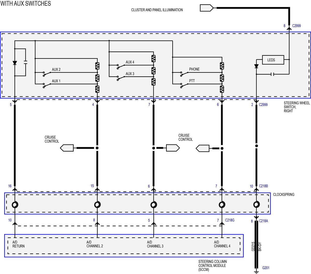

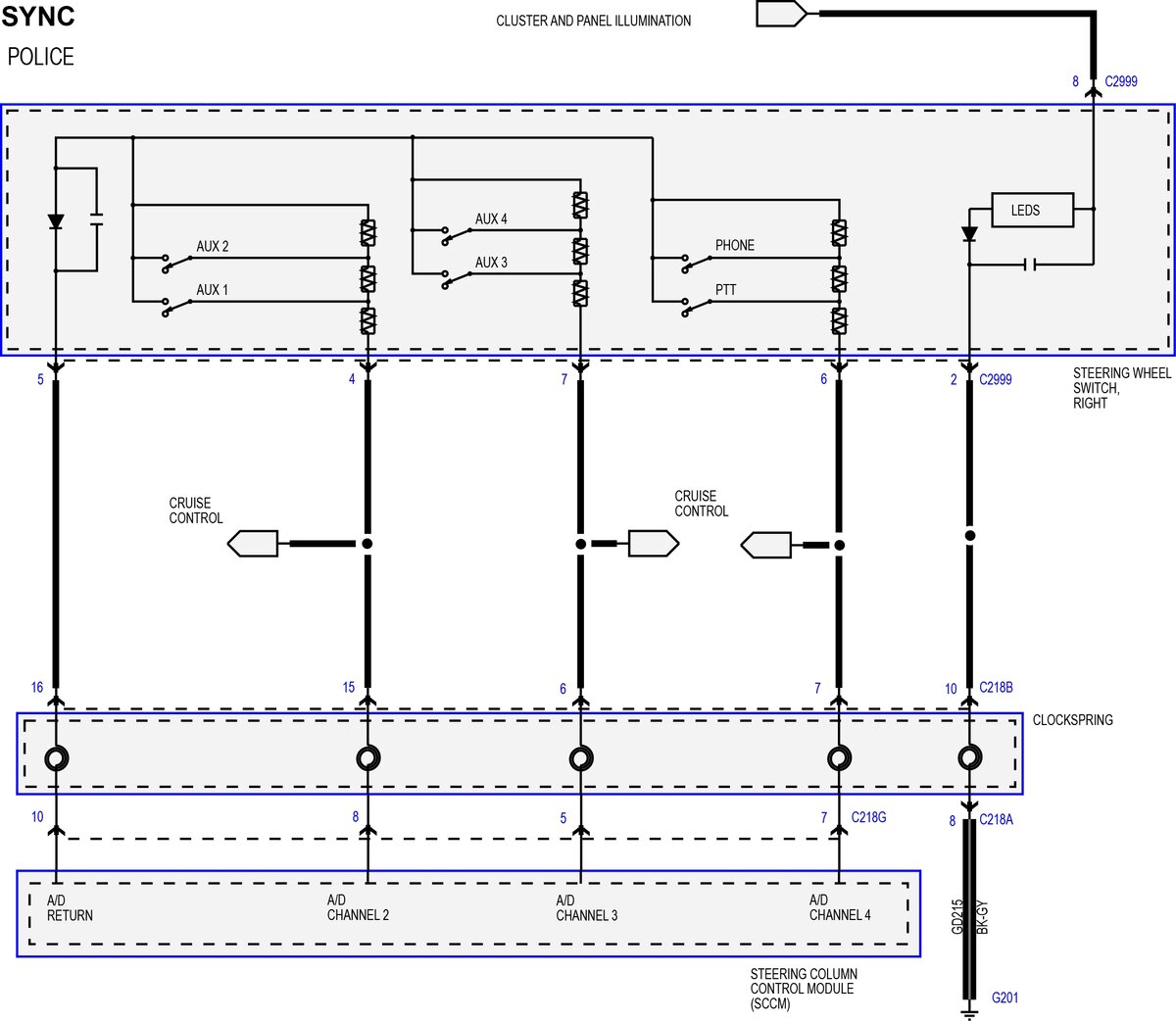

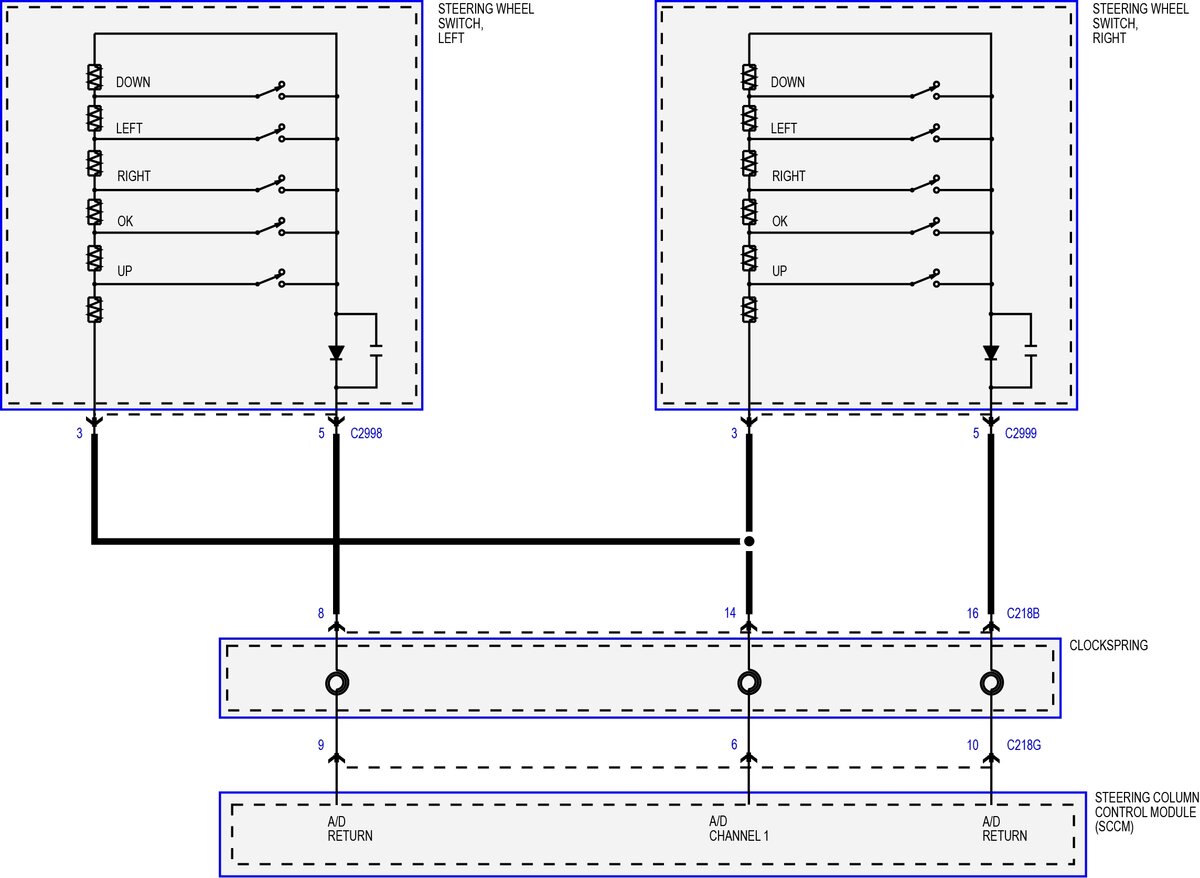

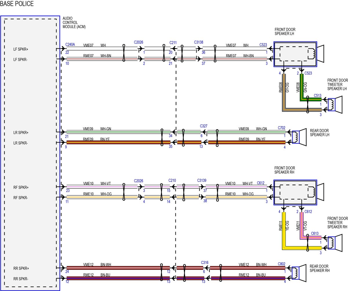

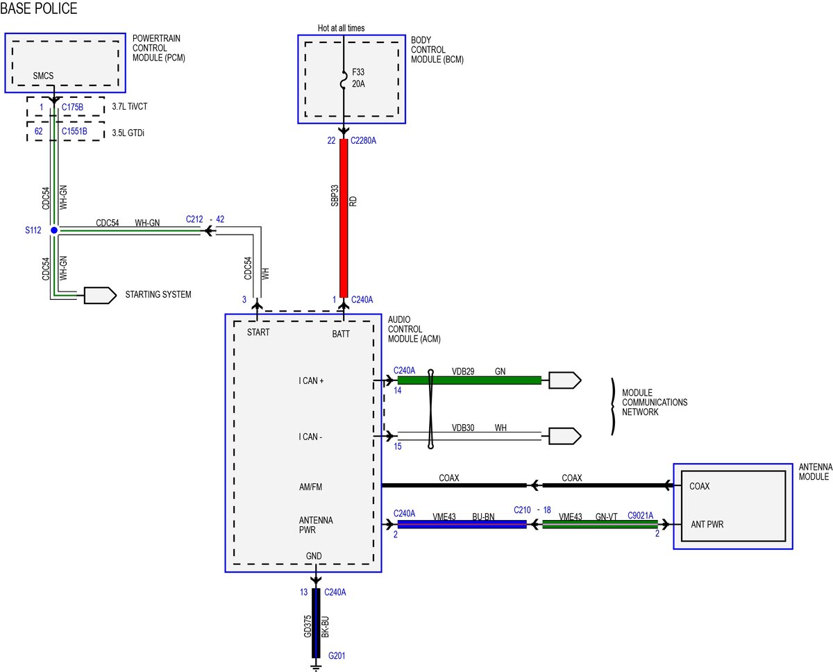

Here are the wiring diagrams for the "base" police package in a 2017 specifically, plus the diagrams for Sync stuff and steering wheel button stuff. There are some other diagrams too if you don't see what you need on these.
Thanks a million for all the diagrams! Very helpful. Unfortunately I can’t find the Acc power to the radio….

Looks like it gets power from CDC54, a white wire with green stripe, from the battery junction box.
It may seem that my PIU may have been butchered when it has police equipment installed. There is two white/green cables(one in harness to CD player and one in harness to sync module behind screen), neither gets power when car is on.
That's not power to the audio unit (ACM), it's a starter signal intended to disable the audio system while the starter may be engaged.

The ACM is always powered, it's turned on or off via network messages.
So sounds like my only option is to find an acc wire somewhere and run to new radio.
