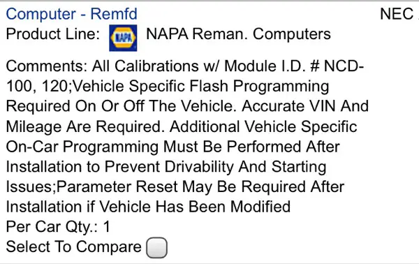

Seeing as how you haven't got any bites..... I thought you had to take it to Ford (or a shop with proper equipment) to get it programmed.
Edit:
Never mind the module number, the notes are the same for the 4-5 PCM's that were listed.
Yeah, but its done the same thing with a PCM programmed by the dealer over a year ago and now this PCM pre-programmed by a specialist.
