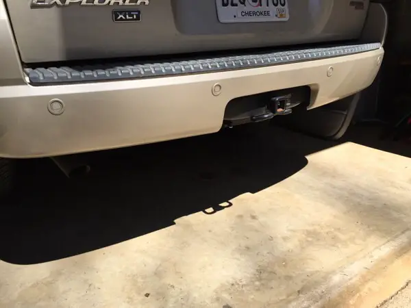

I also recomend getting the Aviator reverse sensors. They sit flush in the bumper and not on some dumb looking rail the explorers came with. They use the same modules.
Here is my other Explorer. The Aviator happened to be the same color.
Also note, the foam behind the bumper is already cut out to accept the Aviator sensors. I don't understand for the life of me why Ford added the ones to the Explorers as they did.
Take some heavy grade paper to the wrecking yard and make a template for the spacing.
