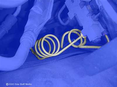

Further since the original line had a flexible segment in it and standard bulk replacement line won't, I like to put a few coils in the line right before the ABS unit as strain relief. Example:
