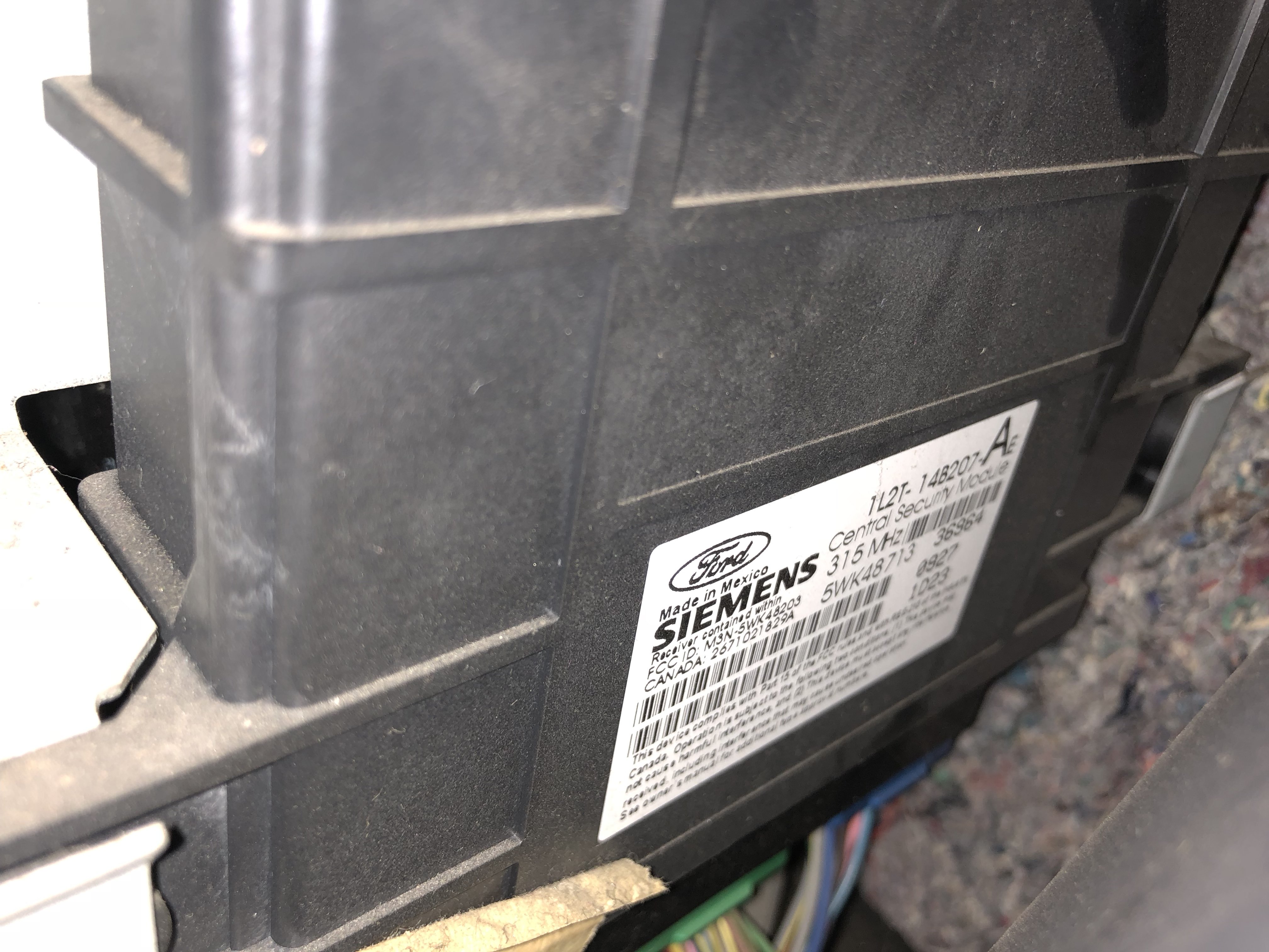

Also I would like to add that I removed the passenger rear quarter panel and retrieved the door code for the Explorer. The door code is NOT working either. The thing lights up green but does not unlock the door. Here is a photo of the Central Security Module. I have done this for my other Explorer and the door code worked perfectly. Has there just been too much damage to the GEM via water?

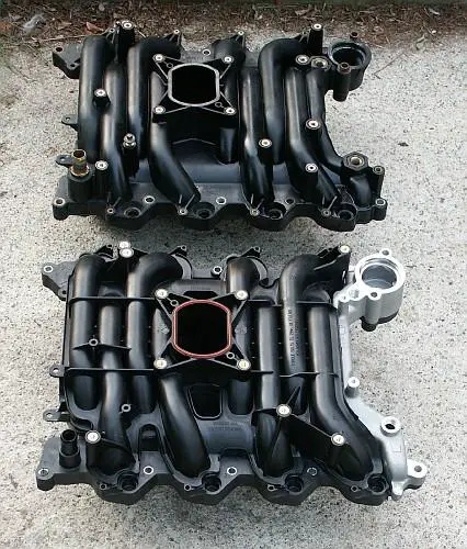

BTW, while I have the 4.0L SOHC (not a v-8 4.6L SOHC 2-valve like you), some brief internet sleuthing causes me to suspect you have a leak in the plastic crossover pipe in the intake plenum (aka "manifold") of your '02 Exploder, which was corrected in 2003 with an upgraded part. You should probably find a 2003-2005 junk yard intake and replace it. Hopefully you did not overheat and warp the heads (since your guage did not spike). The high rpms and resulting from the bad transmission probably just put extra flow/pressure through and already failing plastic crossover pipe. See below:
Coolant Leak (intake manifold) – Some vehicles may exhibit an Intake Manifold crossover (first runner) coolant seepage condition. This may be caused by a crack in the intake manifold coolant crossover.
Effects the:
  • 1996-1997 Ford Thunderbird
  • 1996-2001 Lincoln Town Car & Grand Marquis
  • 1996-2001 Ford Crown Victoria & Mustang
  • 2002 Ford Explorer
There is a replacement intake available that uses an aluminum coolant crossover instead of plastic.
The photo above shows a stock 4.6L intake (top) and the improved replacement with the aluminum coolant crossover (bottom).
Effects the:
