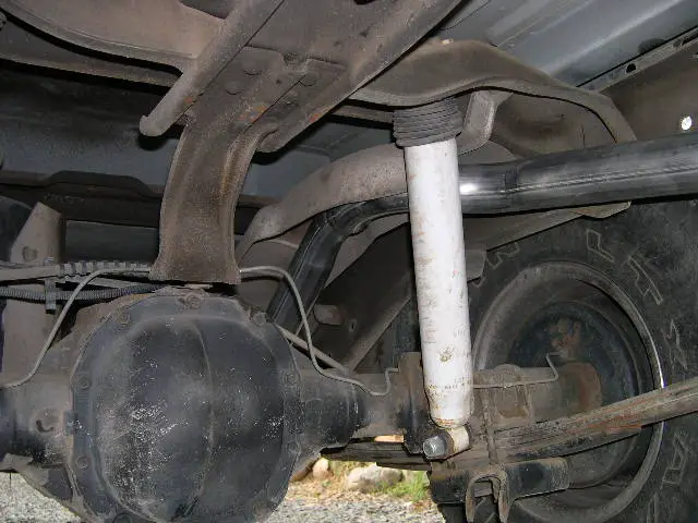

Here's a pic of mine, which is not mandrel bent and is 2.25". As far as getting mandrel bent pipes, dont waste your time unless your going to have a lot of bends in it, which if you follow the same pattern as the stock exhaust, you wont have. I'm really happy with 2.25" pipe too. It added a lot of power on my top end and I only lost a little bit of bottom end.
