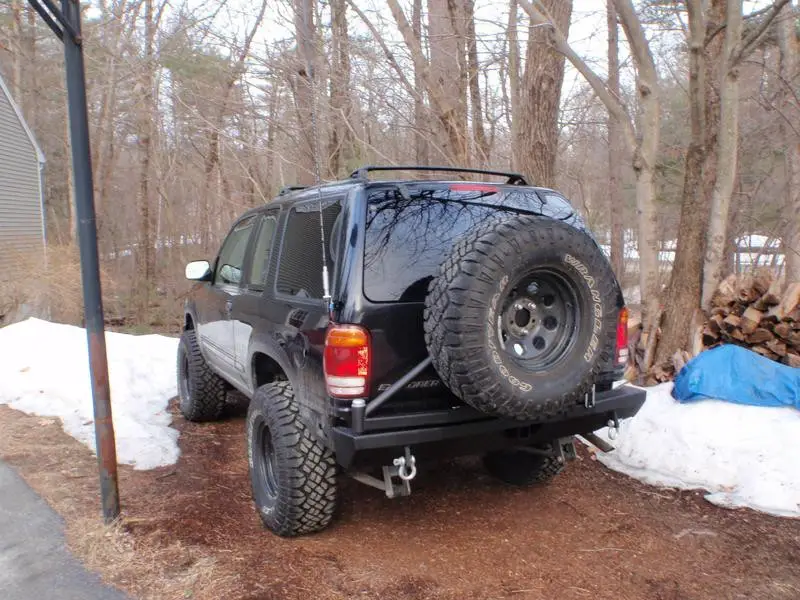

I figured I'd take this opportunity to share my pictures with the community and to plug Jamscal's awesome work. He was even able to accommodate my 3" body lift!
I was tired of having the 33" tire in the hatch area of my truck, and strapping it to the roof destroyed my fuel economy, so I decided to go the swingout tire carrier route. I think the results are awesome.
The only issue that I ran into during installation was likely due to the fact that this bumper was designed for a first generation Explorer. I had to do some trimming of the rear crossmember to get it to fit. The back part of the integrated receiver hitch came in contact with the area which had contained the factory spare tire. It took all of five minutes with an angle grinder to remove the obstruction. Nothing too extreme, but it was an extra step which I had not planned on.
The other issue which has resulted in me not being able to drive the truck, is the fact that the spare tire blocks the license plate. I've ordered THIS relocation bracket and light to remedy this problem.
My only question now is, where is the best place to connect this wire to? I'm thinking of tying it into the rear light assembly so that when I turn on my headlights at night, it will illuminate as well. I'm just not sure if license plate lights are required to be illuminated at all times in MA, or just at night.

I spent the weekend on it, but that includes time for the paint to dry, trimming the crossmember, and fiddling around with the hinge (it wasn't immediately apparent to me how it was supposed to go together).
Actual install time to get the bumper on was about an hour. There were two bolts on either frame rail holding the old bumper on, then I used three bolts to hold the new bumper in place. I had removed the bumper in the past when I did my body lift, so I was already familiar with the mounting setup.
That bumper and tire rack are sweet!! Why not tie the wiring into the existing license plate lighting? That way the new light will come on with the old one. As far as I know, the plate only needs to be lit at night, and legible from 60 feet away. If you tie it into the existing plate lights, then you know it will be legal!

I thought about that, but it would require a very long wire. I'd need to run a wire from the new license plate holder, to the hinge of the bumper, into the body of the vehicle, up to the hinge on the hatch, then down to the original license plate area. I checked my other car, and when the headlights are off, the plate lights are off as well. I think if I tie into the drivers side rear tail light, I'll be good because it will turn on the plate light when the tail light turns on.

License plate has been successfully relocated. I wired it to the tail light. Behind the light housing there are three connectors. The middle connector has three wires, green, brown, and black. I spliced the license plate light wires to the green and black wires of the middle connector so that whenever the headlights are on, the license plate is illuminated.
