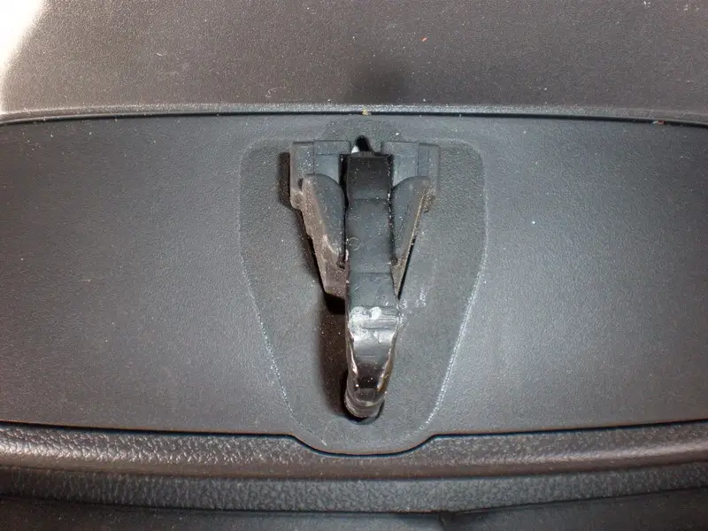

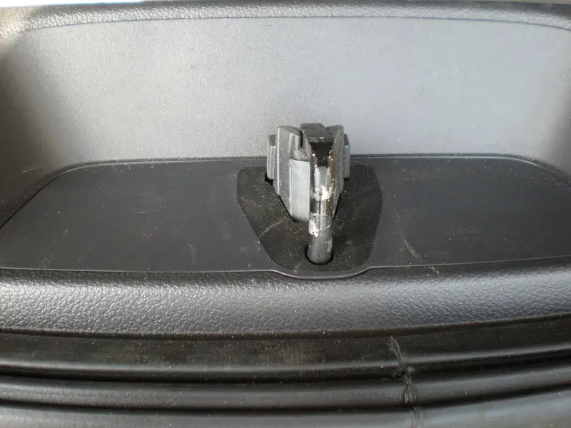

Can someone post a picture of their liftgate striker/latch? I'm talking about the stationary striker that the liftgate latches onto when it closes. Does the striker sit evenly within the plastic/rubber molding? or does it press into the rubber part of the molding like its out of alignment?
Mine is flush with no issues discovered.
Does this help?

Peter, thats perfect, I didn't think mine looked right, especially since the front part has stress lines in the plastic.....
