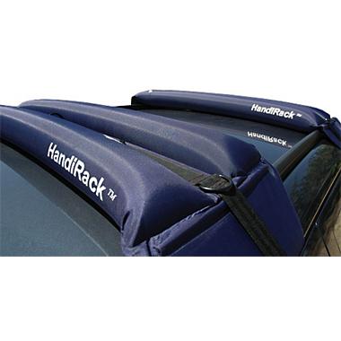

I've used the dense foam blocks made for hauling canoes. They have notches in them to "clip" onto ladder,canoe....... I ran a ratchet type strap over the canoe then through the two open front doors. The doors closed air tight. If you have to do this a lot it's a pain.
look for some cheap roof racks that use suction cups or pads, but fastening them to the roof will be a pain, no drip rail.unless you have the factory roof racks,

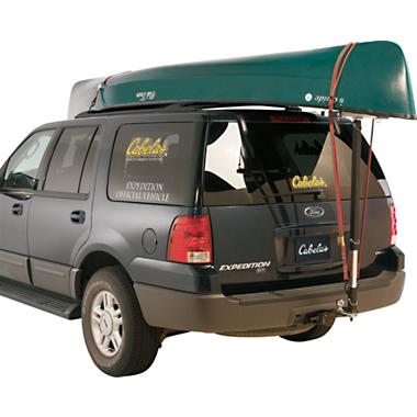

These hitch mount rack extenders work good for carrying canoes, so should work for a ladder. I've seen them mounted in front receivers too, but don't know how bad it would decrease visibility, or if there are any laws against that.
http://www.cabelas.com/cabelas/en/t...061390&cm_ite=0030168017442a&_requestid=42368
Thanks for the replies, inflatable one looks doable. What about a raingutter mount in the front to make for a third crossbar? It would have to be the same height as the stock bar. Does Thule or Yakima or other aftermarket companies offer an add-on to the stock rack?

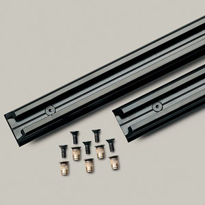

Someone (like Thule or Yakima) make universal tracks something like these...
Oddly enough, I think I might have some sort of universal tracks in my garage somewhere... PM me if interested...
