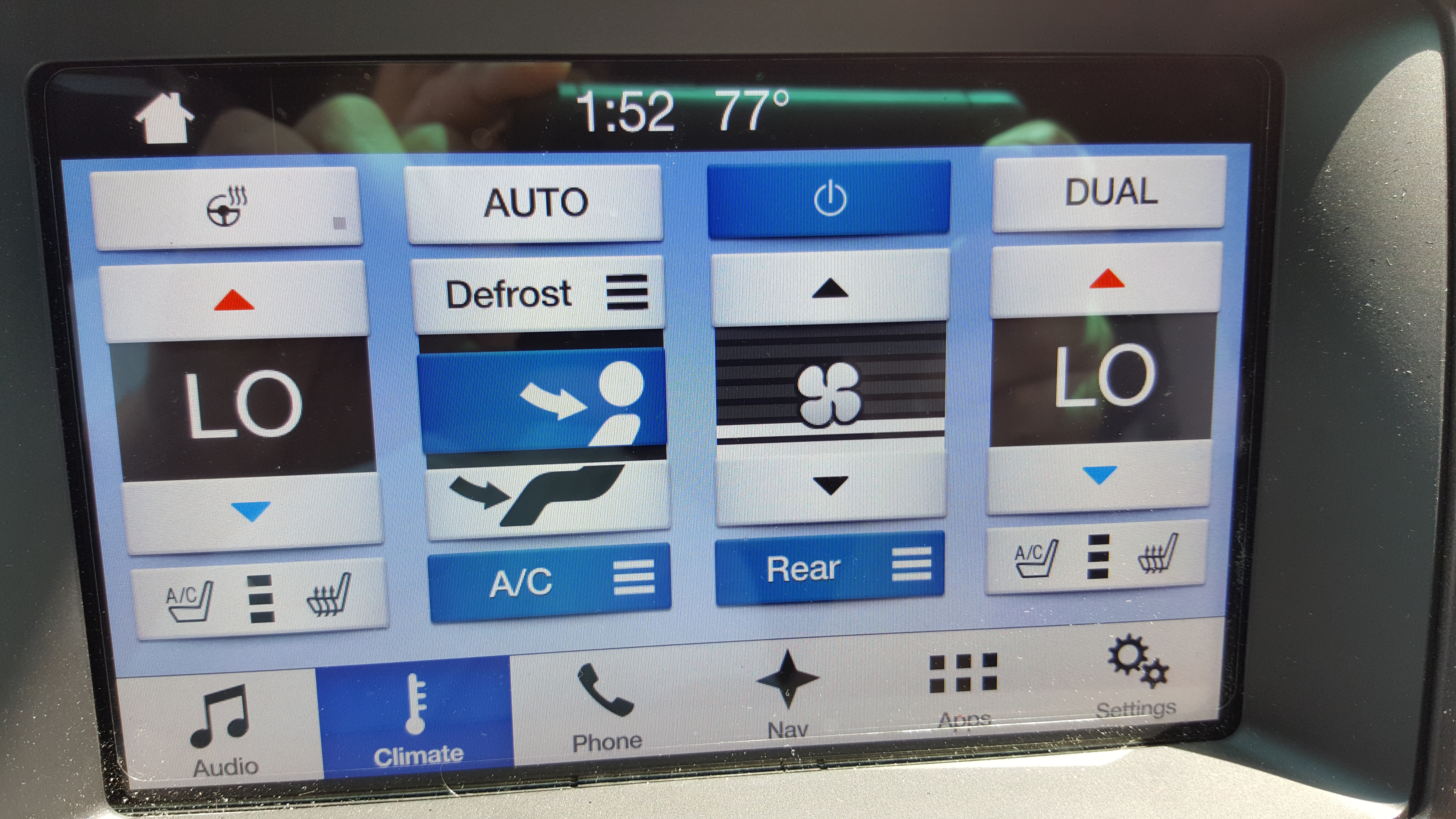

If done correctly this is what you should have. I noticed that when I used the F150 values another value on the same line was changed not sure how. I used the stock values above provided by (Platinum Owner--member) since I never did a back up and then I used the spreadsheet here and everything is working fine now.

When using the value from the platinum spreadsheet, my screen looked like that except the rear button was missing and the a/c button was centered.
