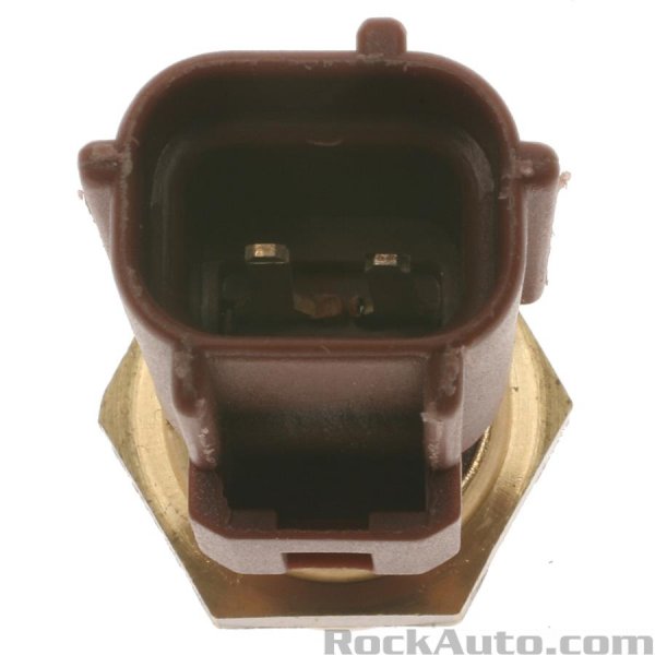

BUT - there are Two Different Wiring Harness Connector Types for your Ex!!!!!
Make sure you hands-on investigate before ordering - notice that at the top of each connector is different.
For this, I suggest Standard Motor Products offering - no need to throw money at this particular part.
Example One - Grey Connector: Standard Motor Products TX104 = $14.86 @ Rock Auto
Example Two - Brown connector: Standard Motor Products TS390 = $16.40 @ Rock Auto
