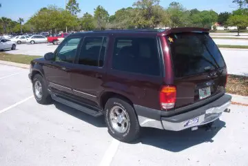

This is a shot of the lowered truck....

Very nice Al!! I know you have the EE bumpstops, but I'm wondering when your truck is on level ground, how close is the suspension to the front bump stops. BTW, what is that part of the suspension called. Is it the A arm?
It is level in the picture.
