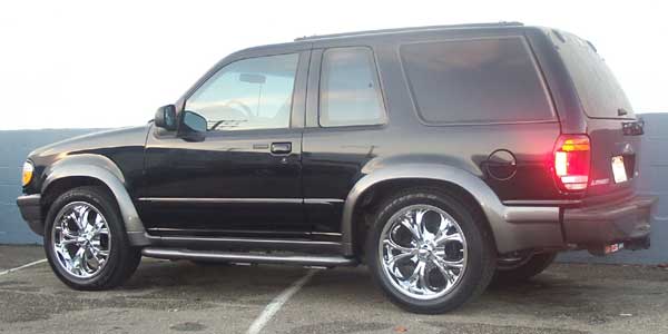

A 2000 Sport has a single leaf spring rear suspension. They tend to sag a bit at the rear. They also come stock with spacer plates at the rear u-bolts. You can get a .75"-1" drop by swaping all four spacer plates to the other side of the leaf spring. There is a trick to it, but I can talk you through it. This goes nice with a 1.5" torsion twist at the front. You may try this first. You still will have to correct the camber at the front and have the alignment done. Most alignment shops can take care of the camber adjust. Of course I feel that the next step would be the Edelbrock Shocks for lowered Explorers and the suspension bumper kit. The X-Spec rear sway bar is is a must for a good handling Explorer. Your Sport has a lot of potential in the handling department. You wont believe how good your X could feel on the road. Here is a picture of a Sport we did a while back. It has no lowering blocks installed at the rear. In 2001, the Sport (like Black Magic) went to the multileaf rear suspension like a 4 door.
