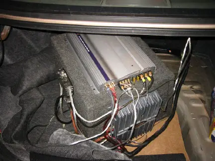

1. he has a rockford fosgate he2 15 subwoofer and a rockford fosgate power 500x 4 channel amplifier. this was the route they had suggested because it was cheapest... why wouldn't they recommended a mono amp capable of 500 watts into 2 ohms (which would power his dual 4 ohm sub nicely)? 4 channels are always more expensive than a comperable mono amp.
2. to hook up this 4 channel amp they sold him very expensive monster cable twisted pair rca's. then as soon as the rca went out of site they used female ---> 2 male connectors that couldn't have cost more than 5 cents each to branch the signal out into "4 channel"... makes perfect sense in a way except that the amp is switchable so that it can accept 2 channel inputs.
3. they didn't notice that the signal from the hu wasn't of high enough voltage to fully power the amp so i had to add an equalizer (to act as a line driver) in order to get the full power from the amplifier

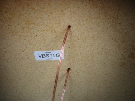

4. and this is the one that is the icing on the cake (the rest are sort of bad) but this one is enough to make you want to puke. they sold him a 150 dollar subzero box for his 15 and they did this (look at the picture) despite the fact that it had a built in terminal cup.
my theory is that they sold him the 4 channel amp so they were then stuck running each voice coil off of a seperate bridged channel of the amp. then when they got out to the install bay the box only had one terminal cup so they didn't know what to do... the results are horrendous--- and this is from a place that claims to be the best in the state. they even do lots of fiberglass work for their customers who have the $$$$- can we say pile of bondo?

he told me that after he got it installed he wondered why it was blowing saw dust out of the port...

My box doesn't have any terminal cups, just holes I drilled, stuck the wires through and caulked.
I hate this box anyway, I threw it together in 4 hours in 100 degree Memphis heat. Was only supposed to be a test box but I've used it for a year now.

hey- caulk is one thing, drilling a hole and then leaving it open is another

Is that 16ga wire they used to wire the subs? Those guys are dumb****s to do that. I'd go at LEAST 12ga for something like that.
yes the 16 guage wire that is supposed to be carrying 250 watts to each voice coil is another thing thats not so great and can definitely be included in the list of errors.
i have 10 gauge running to the subs in my own system with similar power numbers per voice coil (and therefore wire)
