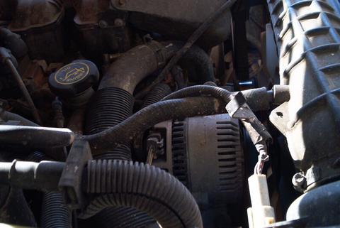

Here's a write-up for my Mean Green Alternator installation. After reading the write up in Peterson's 4 Wheel Drive I was under the impression that I was going to have to modify the plug and the cradle to get this thing to work...no problems like that though. It was all plug and play. So here's the brief overview of how it all went down.
The old alternator:

Here's the reading before the install while running 3 sets of off road lights and max AC:
And here's the final reading while running the same 3 sets of off road lights and the max AC:
I hope this helps someone out!
