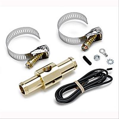

Here is a pic of one you can buy from summit.
http://www.summitracing.com/parts/ATM-2280/?rtype=10
I've also made one using galvanized pipe barbed fittings, drill and a tap. So far it hasn't rusted but its only been in there a few years.
