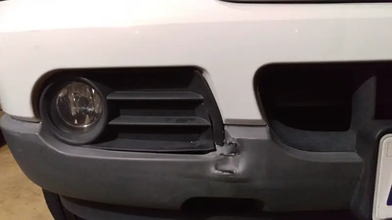

Long story short, I damaged my front bumper (was not thinking when it happened and am kicking myself about it). Not horribly, but I'm definitely going to need to replace the front bumper and the passenger fog light cover. No amount of bondo will fix the plastic. I'm planning to DIY and was reading some old threads regarding bumper repair/replacement. The fog light cover seems easy enough to replace. After removing the old bumper, the hardest task will probably be to paint the top portion of the bumper. A replacement bumper costs $105 on ebay and it says it's primered. Any thoughts on what I should believe with that? Or will I really just be able to spray paint, clear coat, buff/polish without any bumper prep?
Pic of damaged bumper:
I'd go to your local wrecking yard. Though most Ex's seem to be involved in front end collisions. Wrecking yard bumpers are $35 in my area.
You may even get lucky on the color. Also, don't forget to look for Ex's on CL that are being parted out.
Based on the damage I see, you could apply heat to it and mold it back into place. It's called Plastic Welding. There are tools for it, but a $14 heat gun from harbor freight would do it. Key is shaping the plastic with an object once it's good and hot. Just don't melt it too much.

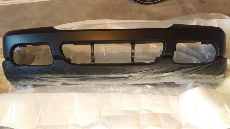

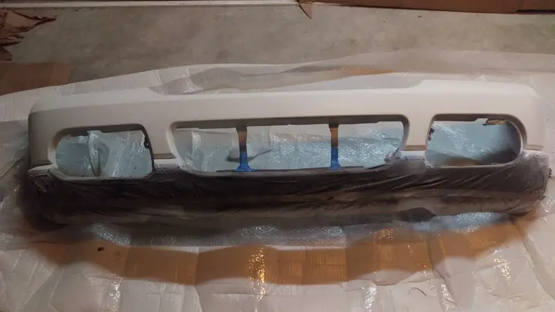

My replacement bumper was delivered today and after opening the box, I was happy to see that the bottom half was already taped off. This saves me a lot of time; I wasn't looking forward to taping off the grey textured part and now I don't have to. I'll probably paint this Friday. Will post pics of my progress.

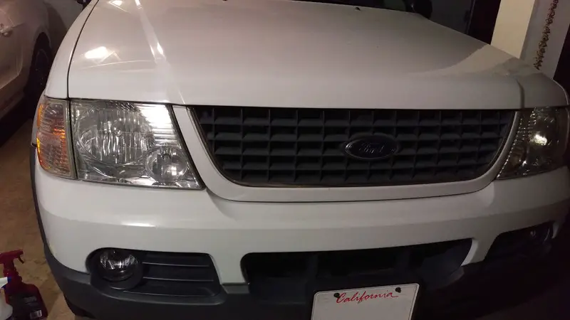

I completed my biggest DIY to date on my Ex. I'm very satisfied with the end result. The hardest part as I had expected was painting the new bumper, because it required the most time, detail, and care. Prior to this, the most I'd done as far as painting was small scratch repairs. Removing the bumper went pretty smoothly thanks to tips here on Explorer forums. Obviously the best and easiest scenario would be finding your exact bumper match at a junkyard, but if I can do this from scratch, anyone can. I used Duplicolor's perfect match for YZ and their clear coat to follow. I'd like a glossier finish for the clear coat, so I may have to add another layer in the future. Or if anyone has suggestions for a good clear, let me know.

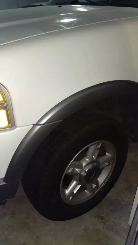

Also, the grey trim/molding that came on the replacement bumper highlights the faded grey molding on my passenger side. The driver side molding matches well because when my truck was side swiped two years ago, the body repair included replacing the molding on that side. Any advice for getting the faded molding to match the one on the new bumper?

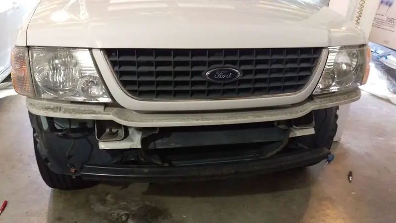

After removing the bumper:

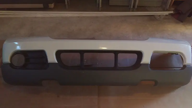

After spraying basecoat (I used three cans altogether):
After clear coat and drilling holes for the license plate holder:
Final product:
