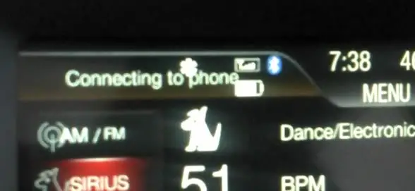

Since I got the X, my phone has paired with no issues. Text/Contact Pics still buggy, but the phone always worked via BT. Yesterday, got in the X and saw a strange screen. Appears that phone is connected (shows battery, cell strength, BT symbol), but there is text "Connecting to phone" that does not go away. Phone seems to think it is also connected, but MFT will not let me dial. Voice says "waiting to connect to phone"

Thanks Cory and everyone else. After work, I got in the X and the MFT hung for a bit and then did a system reset automatically. All seems to be well again. Seems like the re-boot did the trick ;)
