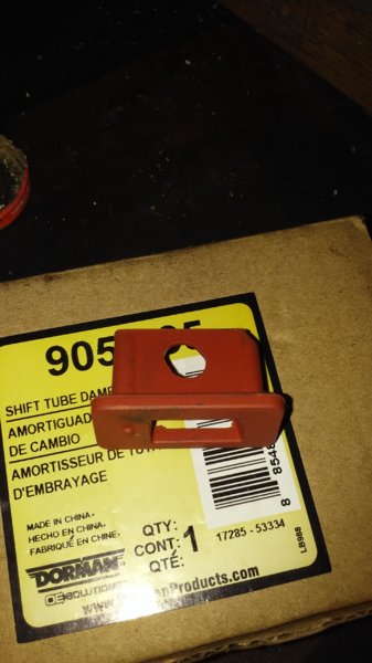

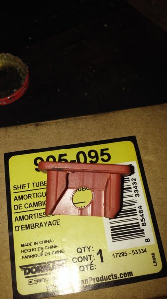

There is a rubber insert in the socket that the shifter goes replace it shifter will feel like new
