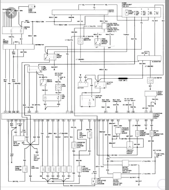

- See attached Electrical Schematic; it's the only thing I'm working to... (Thank you, also, for the suggestions re. better versions)
- NOTE: In the schematic please notice that the ECT sensor and the O2 sensors, along with some other sensors, share a common GRY/RED wire.
[NEW THOUGHT GENERATED...!!] what if "an other sensor" is jacking the common connection...??!!)
- Also notice the GRY/RED wire goes to Pin46 of the PCM. (The outputs from all of the sensors have their own inputs. The ECT is on Pin7 and O2#1 is on Pin46.

- Fourth, I measured the electrical resistance of both wires from the ECT to the PCM; both zero-ohms. Also measured for shorts to Gnd and 12V. It turns out the GRY/RED wire, common to the ECT and both O2 sensors, measures zero-ohms to Gnd. (We'll definitely come back to THAT...!!)
- Fifth, I cut the GRY/RED wire near the PCM for access. The Lt GRN/RED wire from the ECT was already cut, due to my earlier debacle while confusing the 2 temp sensors
- Sixth, I measure 3.15V at the ECT sensor input and quite oddly, about 0.5V on the common GRY/RED wire. Remember, this wire was "shorted" to Gnd.

The GRY/RED wire common to sensors at Pin46 is actually "floating". In electrical terms, it is NOT being driven by Pin46 of the PCM. I conclude this because as I said I understand sensor systems; it could be a Gnd, or more likely a Ref Voltage (which, again Could be 0VDC). But no Ref voltage should EVER be floating!

Now, I'm going to eliminate any ill effects from the "other sensors" on that line. Here's the schematic:
