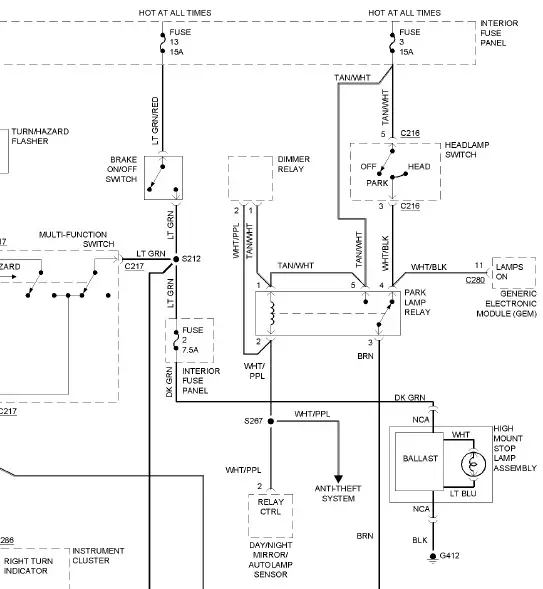

I have a 1997 ford explorer it keeps burning a white with black stripe wire and a tan w/white stripe wire off the headlight switch I have replaced the switch, all fuses and relays that pertain to those wires, the multi-function switch all lights around the truck even those wires themselves but they continue to burn off and blow out the #3 fuse in the interior fuse panel anyone have any idea what I can do to fix this problem I am excellent with vehicle wiring but this has me stumped PLEASE HELP!!!!!!!

If Fuse 3 only blows when the Headlamp switch is in Park or Head I suggest that you disconnect the C280 connector (with WHT/BLK wire) to the GEM. The GEM can develop an internal short that blows Fuse 3.

The fuse size is based on the anticipated load plus a safety factor. The wire size is also based on the anticipated current flow. When the current exceeds the anticipated flow the conductors get hot. I'm surprised the fuse doesn't blow before the wire insulation burns. Did you install a larger capacity fuse? Since the fuse doesn't blow immediately (lasts long enough for the wire insulation to discolor) then there is not a direct short. The GEM is the only active (solid state) device in the circuit.
Yes I did install a larger amp fuse it calls for a 15amp fuse I installed a 30amp fuse I go any lower than a 30 and it blows instantly as soon as Iturn the light switchy on

Replacing a 15 amp fuse with a 30 amp fuse first overheats wires and burns switches. Then it sets your car on fire. If the 15 amp fuse burn out instantly you have a short somewhere. Get a complete wiring diagram and find that short.
