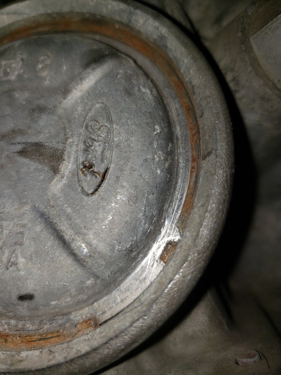

I'm attempting the "Servo Bore fix" (from fordservoborefixsolution.com ) on my 2002 XLS 4.0 4X4 with the 5R55 transmission.. I have the front and center cross-members and the exhaust system out for better access (tried it with those in....wasn't gonna happen).
I can compress both snap rings, which creates a visible gap around the outside of a portion of the snap ring (opposite the "ears" of the snap ring), but the gap is too small to get any kind of a tool into to attempt lifting the snap ring.
I have repeatedly compressed or squeezed the snap ring to its limit (the ears touching each other) and then tried prying the servo piston cap out as well.
I'm not having any luck with either method. Any suggestions on how to get the servo bore cap snap rings and caps out?
This is my 3rd weekend to have my truck up on jack stands and try to get the servo piston caps off..............
