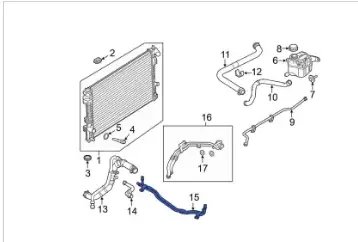

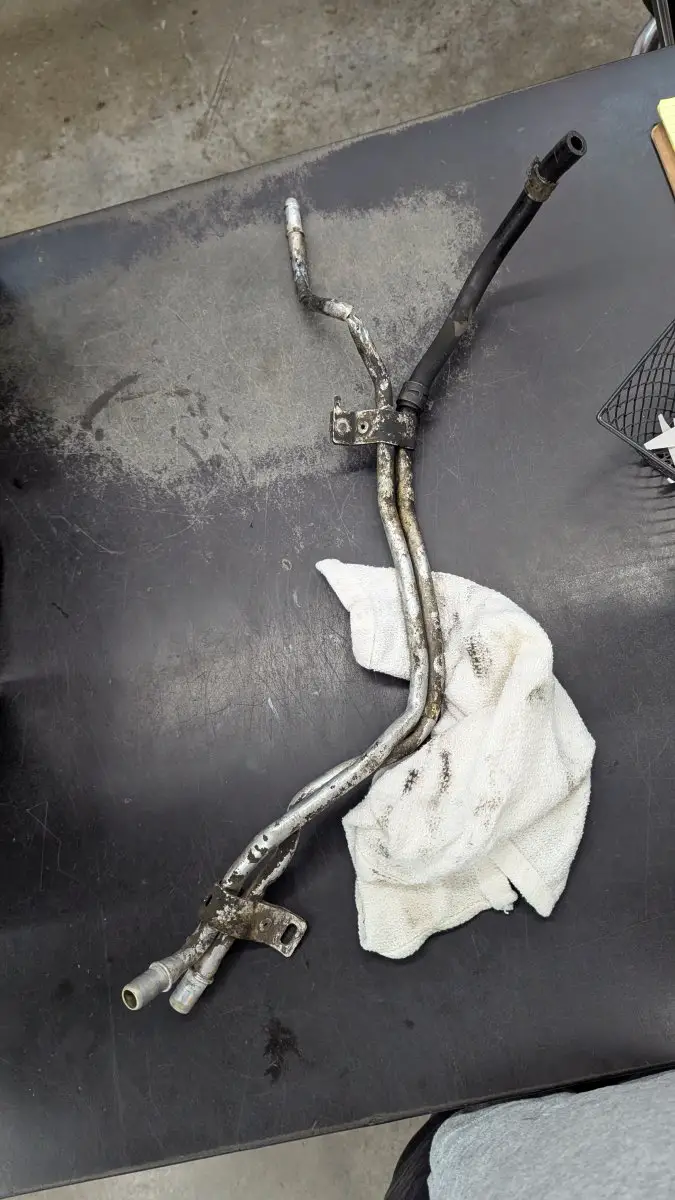

So, TLDR; my transmission mount failed and trans dropped down and crushed an aluminum coolant hose. The hose connects to a rubber piece, then to the radiator.
I took it to a few auto parts stores but they can't seem to find it, so I figured I'd post pictures here to see if anyone can help:
I'm driving to the Ford dealership next and will update here if I get a name/PN for it.
Update: I had to special order this from the dealership (Outlet Tube BB5Z-8A519-H), it was ~$100, but the parts guy was kind and gave me a discount, dropping it to ~$75.

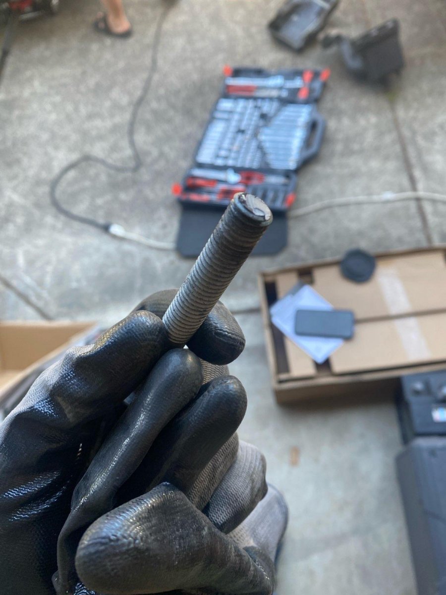

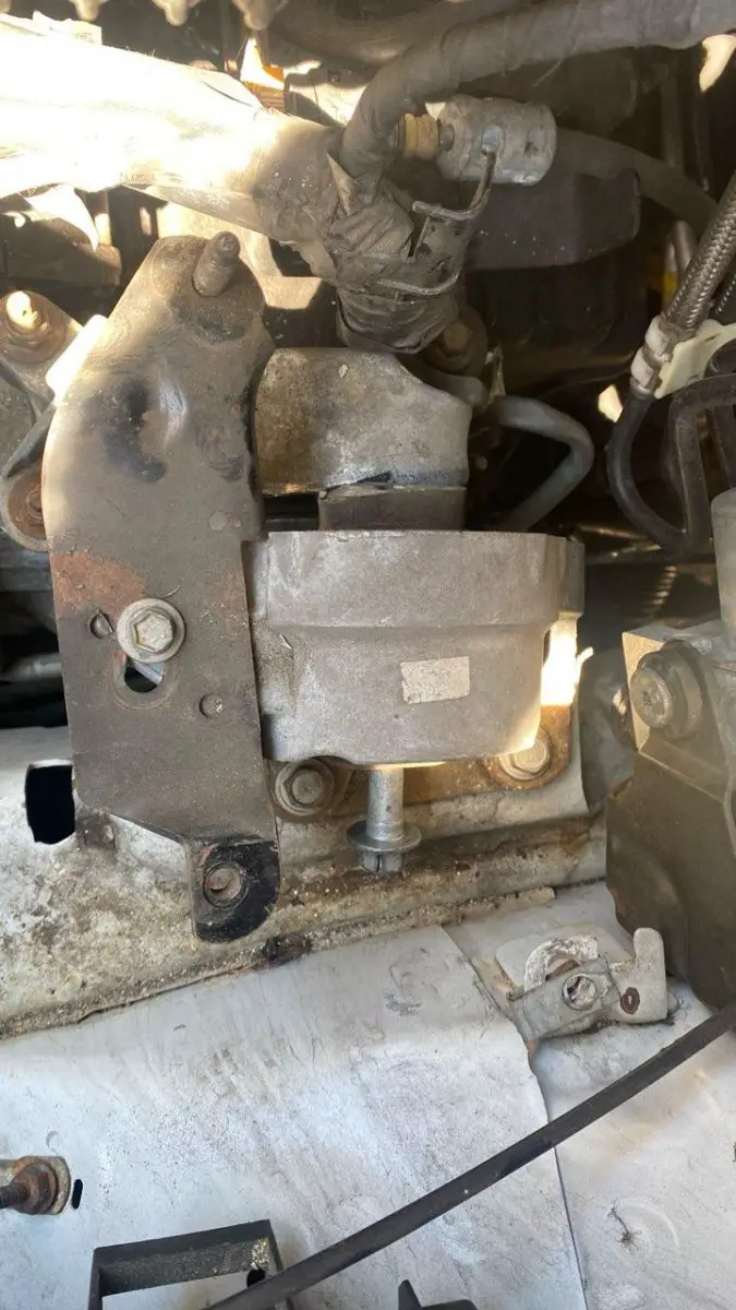

And for reference; The transmission mount failed in a weird way; the bolt holding it seemed to snap off completely 😅

Yeah I had to special order it (For anyone looking for it in the future, it's an Outlet Tube, part number BB5Z-8A519-H) from the dealership
Does it go to the Oil Cooler, or PTU cooler? The Sport version should have them.

They still made some profit on it. Original 2013-2019 Ford Police Interceptor Utility Outlet Tube BB5Z-8A519-H | Levittown Ford Parts ($67.26)
