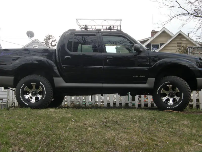

I did a TT and body lift no idea why they said the keys would not work I actually like the ride of my truck it is not as soft as it was stock but not as rough as my last 3/4 truck.

Behold - 3" BL - driven for 12,000 miles now with no problems and I could not be happier.
