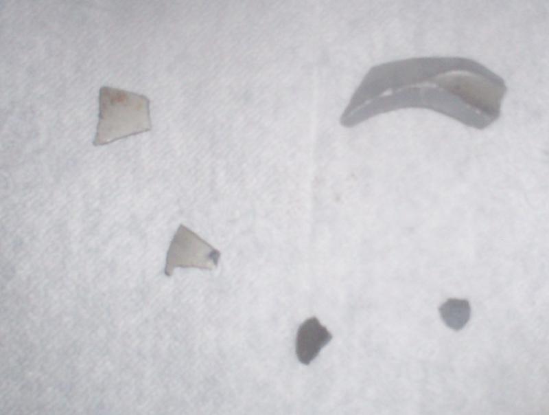

Timing chain guides in oil pan
Well, I went to get back at this morning, decided to clean up the residual oil in the oil pan from taking the filter off, and this is is what I find. Anybody care to guess what is? No need, they are timing chain guides in oil pan. This is the second motor this damn company sent me. There is no need to go further now.
This time I will mention the company name so people stay away from them. They are G&R Auto out of Oregon. I;m currently disputing the charge via my credit card, since G&R Auto says they will not ship another motor, "that motor has been tested and runs perfectly." My *ss. -DW
