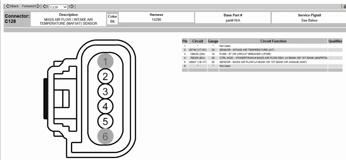

The connector for upstream o2 sensor (bank2) cut off due to a recent accident .
can someone HELP me with the layout of the connector. something like attached pic will be helpful.
