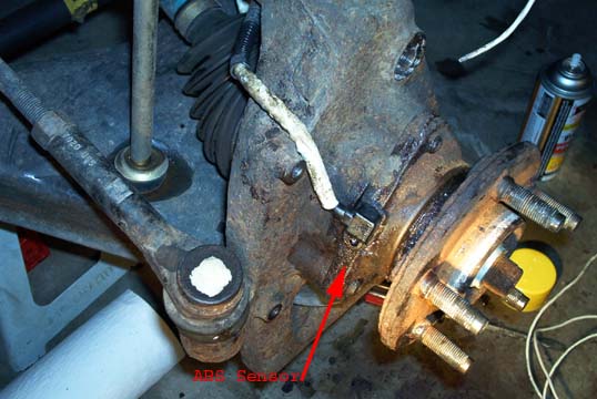

I don't see any cover over the ABS sensor in this picture. Here's a picture of a second generation front ABS sensor from V8BoatBuilder's photo gallery:
On a 1st gen the ABS sensor passes through the Steering knuckle and surrounded by a Red protector which is attached to the spindle. Many times people will assume the sensor must be removed in order to remove the spindle (not true as only the ABS protector needs to be removed); as such they often mangle the sensor by forcing it out. That being said you will most likely need to find a replacement sensor (either new or used). You cannot simply replace the aluminum with sheet metal as the sensor uses a magnetic pick-up to detect the teeth on the ABS tone ring... Obviously a ferris metal (ie sheet metal) will blind the sensor and erroneously indicated wheel lock up.
