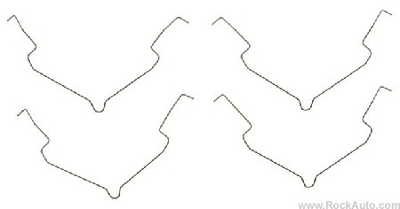

Also be sure you're not missing any springs:
