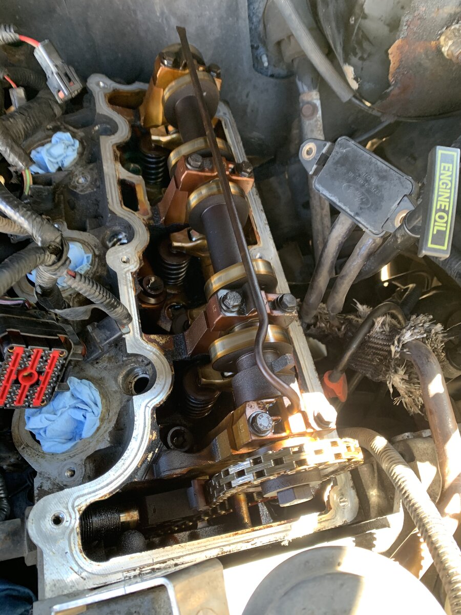

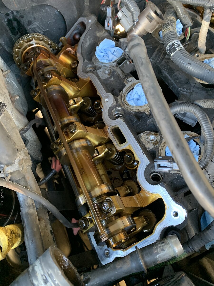

I just finished swapping the valve cover seals, intake seals and any other replaceables on the top along with radiator hoses; the surprise was finding the inside of the engine looking like it only has 10k miles of use—it’s that clean! Unfortunately, I also found the rear timing chain upper guide is ‘missing’ so, I’ll be babying the engine until I can afford a reman sometime in the future...
